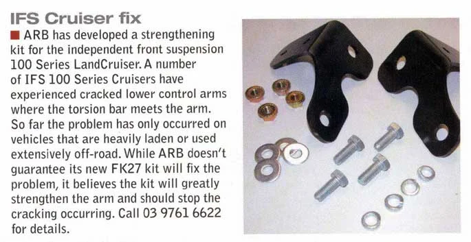

Not sure if this is necessary for you but might be a good idea:

@hoser
thanks for the info.. I'll look into it
