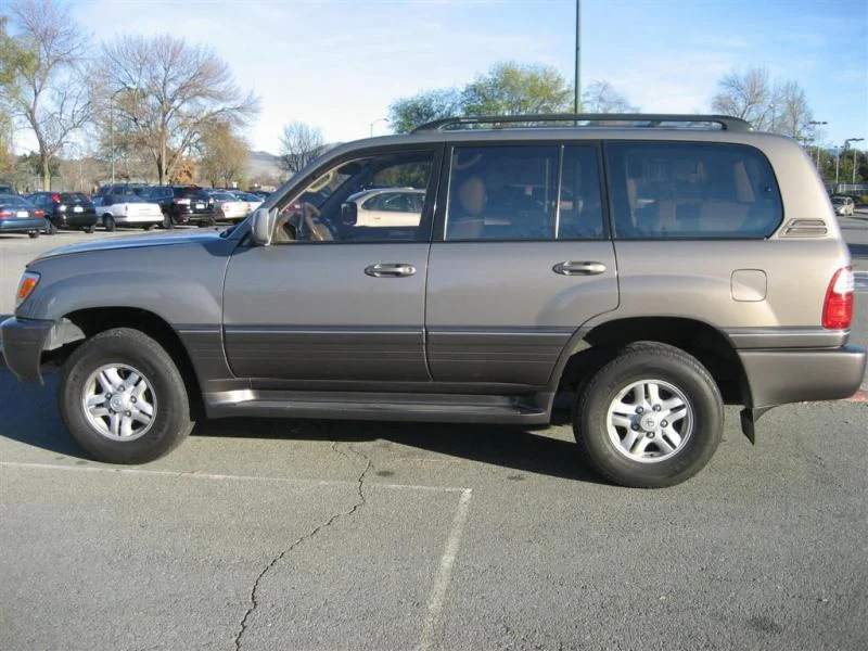

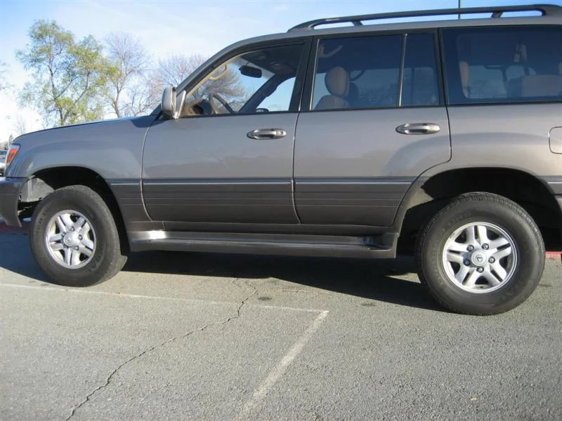

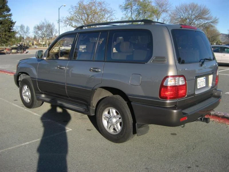

Pictures Added
Sorry it took so long, but here are some pics. Another great thing about not having the AHC is the vehicle is nice and quiet after stopping at a light, no annoying random height adjustments. Whisper silent, the way it should be. Yeah, I know, gotta get some bigger tires.

hey that looks totally stock looks great for 10 year old with 170k on it show me another manufactr that can say that about their vehicle. ok enough praise did you change any of the torsion bars etc? if you have time can you list what was actually changes etc mine is still under warranty but very frustrating with the movements (06 lx 43k miles) thanks

....what mine used to look like, hah. Looks good, but daymmnnnnnnnn need bigger tires now!!!
