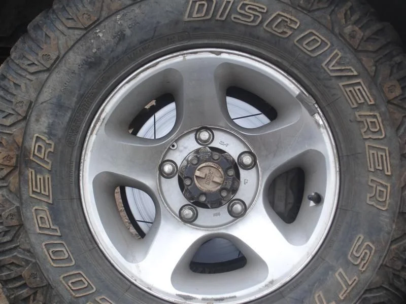

Will these wheels fit?
I don't think anyone's asked this but I really like how these wheels look. These are usually found on aussie 100s. Anyone know if these will fit my '01?
BTW, got this pic from 4wdaction.com.au
hope the owner doesn't mind.

That's a SFA 100, dunno if those are still 5 lug

here's a shot of the lugs

The 105 wheels have the same bolt pattern but in a Zero offset which will not work. Those look like ROH brand wheels, specifically the "Impact" model. They have fitment for both the 105 and 100. Keep in mind, the 100 series version will look different.

Quote:
http://www.roh.com.au/
so i'd have to get a positive offset for my 100? that's where the difference will be I assume, and I guess if that's the case, i'd be SOL, cause to me, that's what makes the rims.

Yep! Ya gotta love the flat wheel look if you drive a 100.
