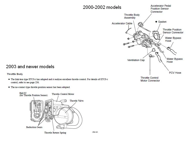

Brake cleaner will remove the buildup that is on the throttle body and plate, any residual will also burn, so it's fine to use. You can use an old toothbrush and rags or paper towels. Latex/nitrile gloves are also nice.
There is no Idle Control Valve on that vehicle. The idle is controlled by the Electronic Throttle Control System.
