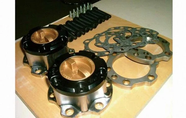

I have seen these selectable hubs from Japan by MORISSHU which are for the 100. (retail: 89,000 yen which is over $800). No part-time T-case though.

Quote:
something about the orange hubs just "looks right" on a Land Cruiser.
