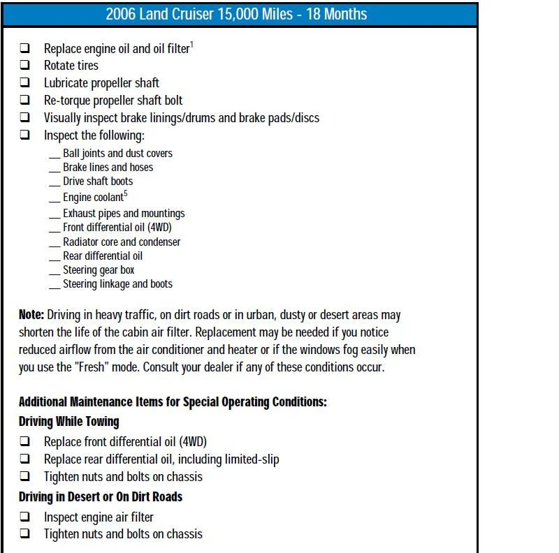

Do you have the owner's manual or maintenance guide? If not, here's an excerpt:
For the ATF, you would need to do a fluid exchange or a Rodney flush (search for this).

The vehicle has only 11k miles...just change the oil with a quality synthetic and go 8k to 12k between oil changes...but occasionally check the oil level. Also, I would really reconsider doing anything to the tranny until at least 50k...then do a drain-n-fill with Toyota stuff. The diffs still have Toyota's factory gear oil and should stay that way for at least another 25k miles...IMHO

I think the 15k maintenance calls for changing the front and rear diff oil if you tow...
Since I don't know what engine oil is in there and since I don't know how hard the car has been driven, I thought about duing the 15k now and get the best synthetic in there!
