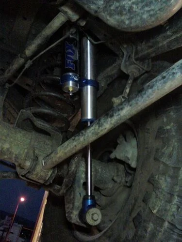

Hi Guys,
I currently have AHC in my crusier and want to replace it.
I am not getting the suspension system locally, and will have t import the kit which either includes Fox shocks or Bilsteins.
The one for Fox costs about $3250 plus importation costs, and the Bilstein costs $2150 plus import costs.
Does any1 have any knowledge about the two systems?
Which one would you go for?
And i guess the last question is, Is the cost justified???
Cheers!

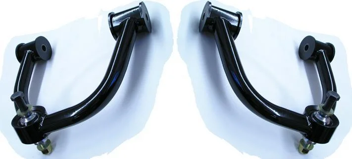

not familiar with any coilover setup for 100 ifs. However, we have long travel upper a-arms that can be used with multiple shock options and allow more down travel. I run the fox remote res on all 4 corners, and it is AWESOME on & offroad. A few run a similar setup, and we set one guy up with these arms and Bilstein shocks (5100) and he reports the ride is much better than OME. This also allows more droop in the front suspension.
http://forum.ih8mud.com/100-series-c...uspension.html

Do the Foxes still require custom-made brackets for a 100?

I think they do require custom brackets (Fox shocks) as there is an additional cost for their instalation.
Although i never got that far after i heard the total cost.
Given the above choice what would you go for????

Carl (JTS above) can supply you with the OEM style upper mount (post type) Fox shocks for the rear. The fronts however do require a post type adapter as far as I know...but Carl would be the one to ask.
See #74 & #76 here:
http://forum.ih8mud.com/100-series-c...-review-3.html
The front adapters are easily fabbed BTW and should be seriously considered along with Carl's upper control arms to gain maximum droop out of the stock IFS 100 configuration...

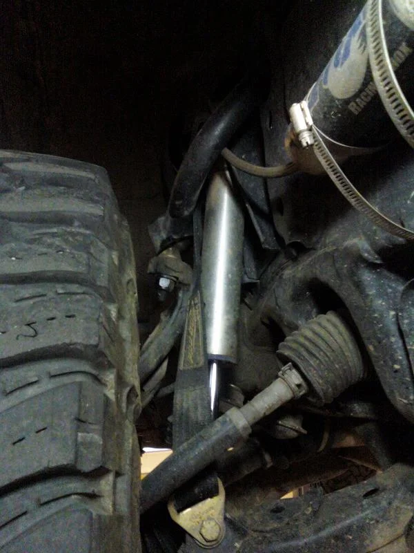

fox
Here are some pics of the rear fox shocks (bolt on stem top) the front fox shocks w/ limiting straps and pin-eye converter (bolton) at full droop for the front. Also a pic of the uniball a-arms seperately.

That is our set up, that we have been quoting for, or Bilstein, and anyone who thinks OME is in the same ball park as either the Bilstein, or Fox, has had the marketing work on them ;-)
The rears in the above truck are longer than the FJ looking set up ringpinion man runs, and our front are long enough to run 3.5" front lift, with pour 4" rear coils, and our bump spacers for 35"s on the right offset rim, and the sway bar mounts modified to stop the sway bars hitting the shocks, or stopping the travel.
I would be interested to try a set of top arm,s to see how much more we can get from the front, but I think the chassis bushes may be a limiting factor, to get another 50mm down travel we would have avalabale, with everything, except the top arms at the moment stopping us.
In the rear we also could potentially run another 1" of droop, if we chnaged the shock length again on the Foxs.
