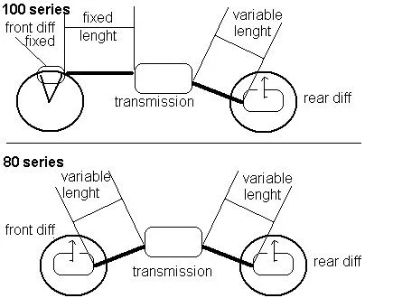

Just a little note; I don’t think the front driveshaft hydrolock or subsequently make the clunking noise upon take off. Due to the IRS and fixed front diff it doesn’t change length.
br

The rear driveshaft logic does not apply to the front driveshaft. The previous threads about the “thud” and “hydrolocking” are related to the rear driveshaft. Hydrolocking occurs when the rear axle moves up, and compress the rear driveshaft. If over greased the rear drive shaft won’t compress sufficiently and you’ll get a thud. Upward axle movement happen during acceleration or hitting bumps. I guess an 80 Series could have a front driveshaft “thud” under braking or hitting bumps.

Excellent illustration!

Yes, that explains a lot, I appreciate that. So I guess I'll clean/re-lube the rear drive shaft and see if that fixes the thud I'm getting. I'm guessing that the grease I see is just *some* of what should be seeping past the seal? Now that I look at it again, it isn't a *lot* of grease, but it certainly appears to be compressing some (maybe 1/4").
Another thing - I'm guessing that lubing the front sleeve yoke isn't as important if it never compresses?? Hmm..
