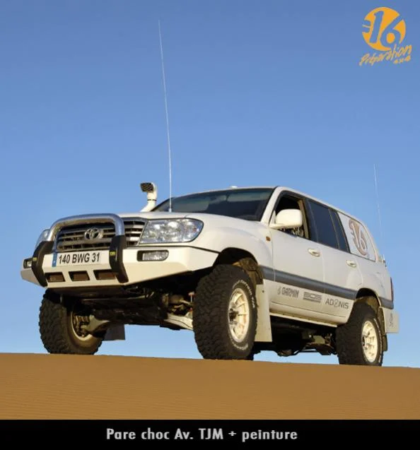

Only thing I found regarding 285's rubbing was when Loud was running them on his fancy spinner wheels pre-lift.
I didn't find any reports of 285's rubbing on 16" factory wheels. Regarding 295's what I found was that you should be planning on lifting pretty soon after installing 295's.
I'm about to get a set of either the BFG AT KO's or Nitto Terra Grapplers. Everyone seems to say great things about the Nitto's and you can get 5 of them for the price of 4 AT KO's. Of course you can split the difference with the Goodyear Silent Armor tires, which seem to get excellent reviews.
edit - I would like to see the BFG AT KO 265/75R/16's on an un-lifted 100.

Yeah, my wheels stuck out 48mm more then stock on each side...causing the 285s to slap the fenders. Ive got stock wheels now and they dont rub, even when I put the AHC in LOW.
I think I can find pictures of a white 2003 with the BFG AT KO 265/75R/16s and stock suspension, macneills buddy that they just put the TJM side bars on had em.
EDIT - this is the only picture I seem to have

Well they certainly look comfortable under there. A little more narrow (-0.8inch) and a little shorter (-1.1inch) than the 285's according to the BFG website.
I guess the 285 would do better if I lift at some point in the future. Most of my off-road driving I've been doing has been on jeep / fire roads, some sort of steep with a lot of loose rock. Am I right in thinking narrow is better for that sort of stuff?

FWIW, I think the 265s are puny. They came off his old Rover. I believe 295s are the largest you can go.

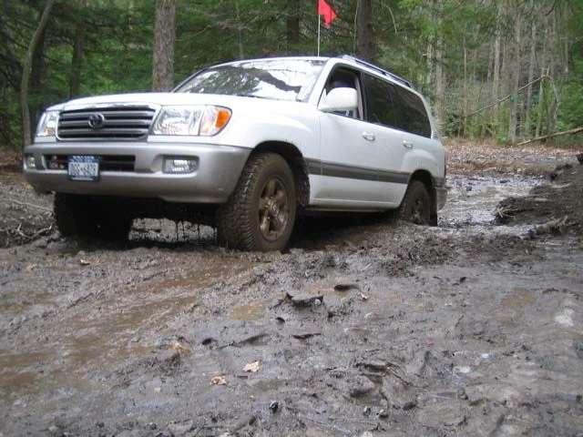

Quote:
Originally Posted by uzj100 View Post
White letters in and not exposed.
but... but...
