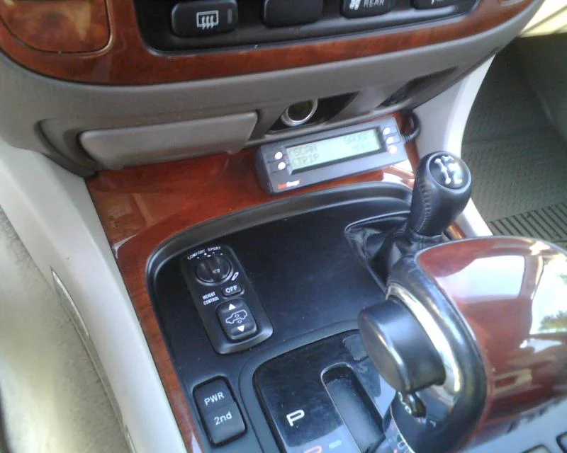

Scangauge II install
Got the SGII installed last night. Pretty pleased with the result. If you install one, no you can't center it due to the ashtray (and yes, I figured that out before attaching it ). Have to go through the set up of it today and figure out how to use it, but it's easily viewable while driving. Thanks to travis351 for the location idea. I just routed the cable a bit differently....
But this is especially useful in an older 100. My 2000 doesn't have any kind of trip computer (other than on speedo) at all, so this provides that plus a bunch of other data. Took me 30 minutes to do, but could do another one in 5.

Nice, mine should be arriving today. I was sort of surprised not to find some sort of trip computer in my LC, unless you went with the full nav.
If I weren't going to stick with my factory in-dash, then I might consider a single-DIN unit so I could mount the SGII in the remaining opening. Otherwise there's not much dash real estate to play with in the LC.

That would be a great idea if single DIN. I got the Nak fixed, and like the factory look and sound of the system.

The SG is just barely too tall for a DIN opening, I tried that with my 80. So on the 100 do you have to relocate the OBD port?

I wasn't aware that something existed that was so easy to install. Can you briefly tell me about your install?

Sure. Per the earlier post from travis 351 and viewing the threads, I knew the OBDII port was above the gas pedal. So, I pulled out the ashtray, and gripped the cup holder and pulled up and it popped free. Disconnected the seat heaters, put it in "D" and was able to rotate the panel up and over the gearshift and into the driver's footwell. Just fished the wire up and under the ashtray, pulled the excess in near the shifter, and left just a little wire sticking out. Then rotated panel back up and over, reconnected heaters, and while holding the amount of wire that I needed out, popped the panel back on. Used just one of the pieces of velcro included so I have a spare if necessary. Started the truck, plugged in the OBDII end, and it's a done deal. I think I have to tell it engine size, gas tank size, and the cost per gallon, and maybe a few other things, and it does the rest. Interesting to see near realtime what mpg is. Going up the hill out of the hood I get a slamming 3.6 mpg! But it's pretty sweet, and easy to read from the driver's seat. You can customize what it shows you on the screen as the default, too.

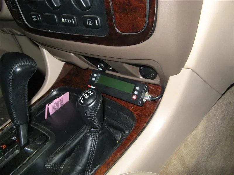

Yea, I'm cool too! Not that the 80 was a difficult install, but damn that was easy. Not really concerned about monitoring much on the 100, but it's fun to see what horrible gas mileage we're getting.
