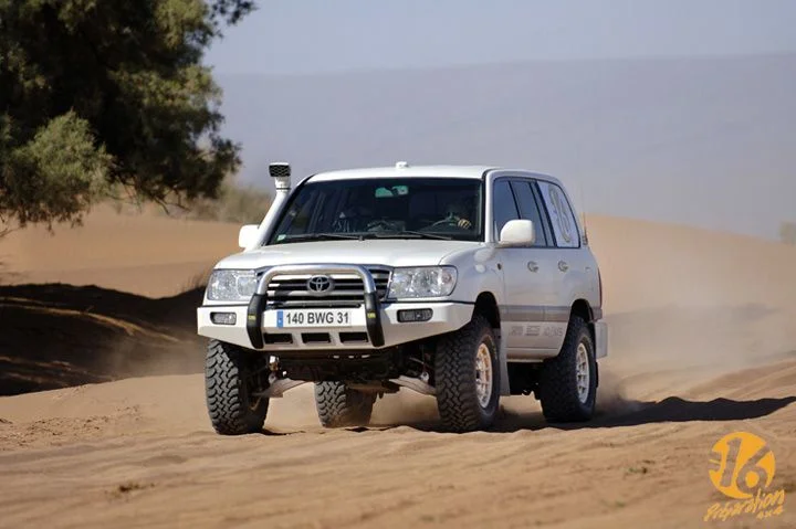

Very nice HDJ100
This was posted over on Expedition Portal but I knew you guys would appreciate it. Some very cool and clean mods. I've invited the owner over here too.

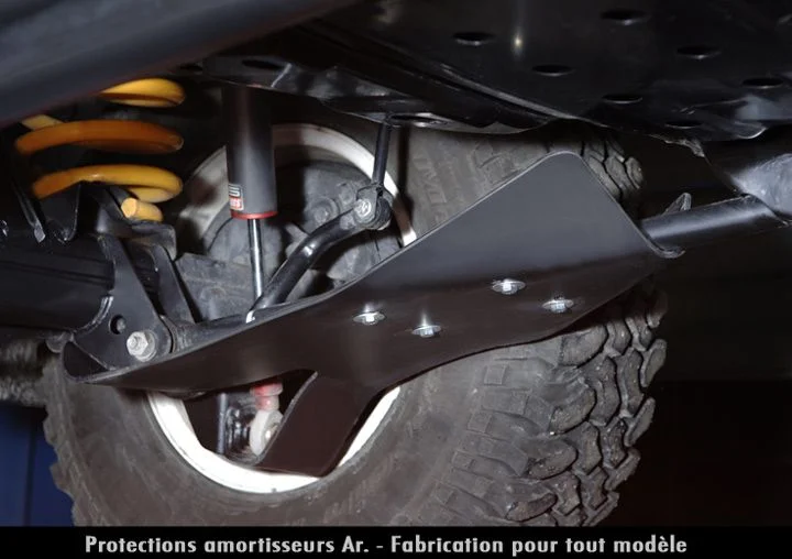

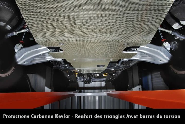

Pretty cool. Like the control arm/shock protection. And nothing like a full CF belly plate.

Still trying to figure out that control arm plate. Looks like it's bolted to the length of the arm, has one finger to pick up the axle end of the arm, and another that picks up the shock mount. Thing I can't figure out is it looks like it's static attached to the shock mount. Wouldn't that bind up the rear axle/control arm movement?

It's hard to see from the pic, but to me it is bolted to the arm only and just floats and is not attached anywhere else so no problems. This combined with some extra support as previously shown here on mud by Slee or Shotts or others could be a good option.

That's gotta be the case TD, just can't see it, weird angle on the pic or something. And you're totally right about the arm, if it's not beefed up it'll still just bend.

As far as these skids? I'd a ripped off those bolts by now.

You'd punch through the CF before you'd rip off a bolt.

His truck is used as Toyota designed it for. Blasting across the African desert, not rock crawling

...and rear skids are to protect shocks against stone projection
That's a first needed equipement, but you can DIY with polymére ( 3/8") lighter, cheaper, easyer to form and probably much resistant
