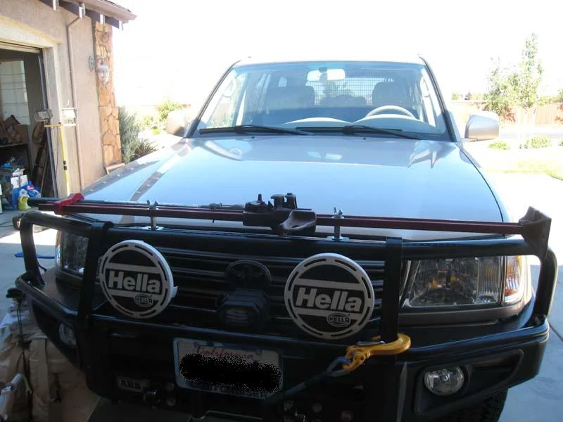

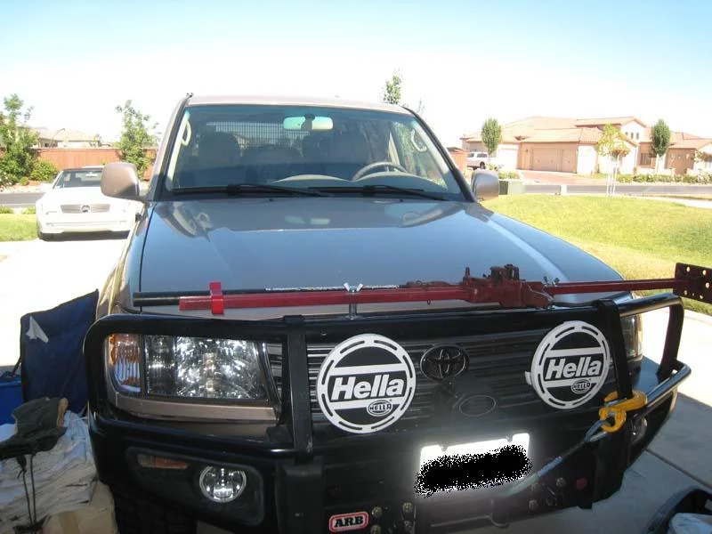

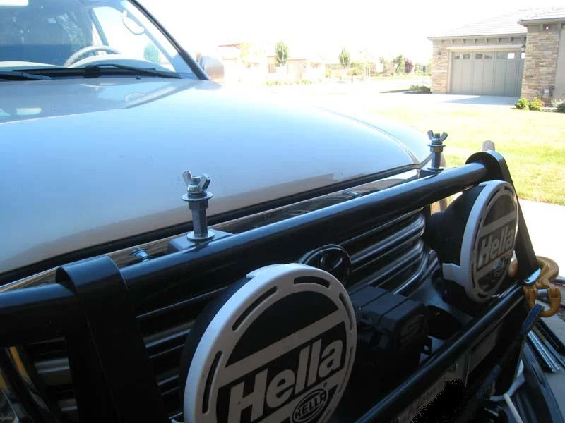

Here are some pics of how I mount the Hi-Lift to my front bumper. You could also get some of the bolt-on ARB antenna brackets and mount those so they point forward and that way you can mount the jack out over the front of the bar as well (This is what I did on my old 80 and it worked great). I have a bike cable-type lock to lock it to the bar if I want.
