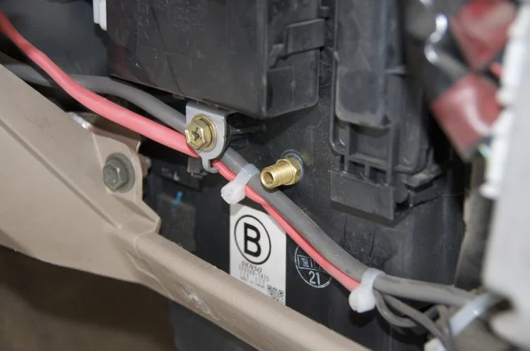

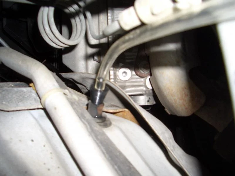

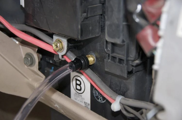

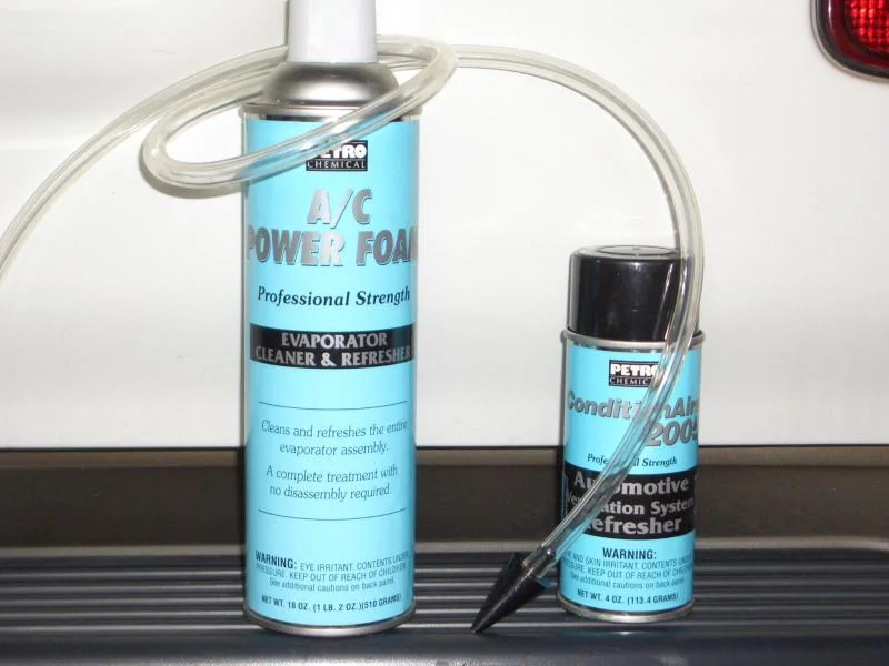

Finally received the AC Evaporator and vent cleaner. You need to drill a 1/4" hole (be careful not to drill into the evaporator!)...thread the included fitting into the plastic evaporator housing (I installed the fitting just to the left of the filter slot). I removed the WAY dusty filters, put the filter cover back on, connected the hose to the fitting from the aerosol cleaner can...and sprayed until the can was empty.
You'll get plenty of gunk to drain out of the evaporator housing...be sure to have a catch pan...it takes about 1/2 hour to 45-minutes to do its thing and then it starts draining the residual mess out.
Sprayed the vents with the included vent cleaner/sanitizer. Put clean filters back in...buttoned it up and done. 1/2 job. BTW I reported in another thread I have successfully been washing the cabin filters out...works like a charm so far...and a BIG savings since they get clogged SO fast out here in desertville .
I could feel the A/C air was quite a bit colder after cleaning the evaporator. And it doesn't smell dusty anymore.
I think I'll keep a couple of these kits around...for more frequent use down the road...er trail .

where does it drain out from?

From the evaporator housing to the puddle you commonly see on the ground.

There is a plastic hose that connects to the bottom of the evaporator box and runs down along the PS frame rail that allows the accumulated moisture to drain freely. You want to check to be sure this hose is not clogged. Run a piece of wire (fold the end of the wire over or protect it so that it doesn't hang up/tear the hose) from the bottom side of the hose up.

oh so there isnt a special drain it just uses the regular drain? Cool, very simple I like it.

Yep...uses the existing drain (assuming it's not plugged...but that's an easy fix too if it is plugged up).

did you open it up to figure out where to drill?

Yes.
This isn't the only place to install the fitting...another spot might be on the filter housing 'cap'.
Maybe put this in Tech?

how long does it take to get in there and open it up?

Glove box door comes off: 2-screws and about 5-minutes or less; then the upper glove box latch panel is removed (3-screws) in about 5-minutes or less.
It truly is a 1/2 job. If you know evap water has been draining after A/C use then you know the drain tube is not plugged. However if not you may want to rotoroot the drain tube with a piece of stiff wire.

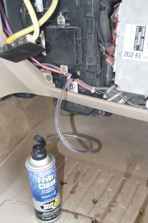

i just got my kit today...however i plan on just using the ac drain to connect my can i am going to upload the picture of the kit in a bit....its made by petrol

Good idea!

ok i've attached the ac foam kit that i used today...i attached it to the ac drain...not too difficult i just removed three clips in the fenderwell and pulled back a splash shield and was able to hook up....i go the foam as a sample from the rep...let me know if anyone is interested and i can see what i can do get try and get some more....ac seems to be blowing colder sooner but i messed up and forgot to record the time it takes to get cold and how cold it gets now

Just did this over the weekend. Some modifications that others may be interested in.....
1. Removed (and cleaned) the air filters prior to the cleaning with Frigiclean
2. I put the schrader valve in the door for the air filters. near the top that way I didnt have to worry about hitting anything. This worked well and doesn't interfere with anything (I left the valve in the plactic and capped with provided cap)
3. Followed the directions, and re-inserted the air filters afterword.
Definitely easy - mine wasn't that dirty - you can preview most of the evap pretty well through the air filter "door" if you were curious on whether or not you might need to do this.
