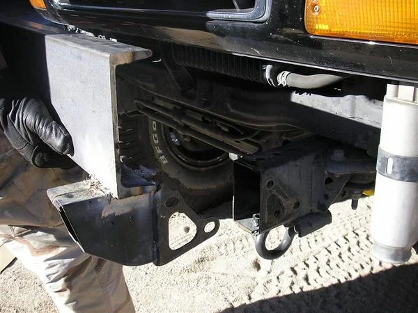

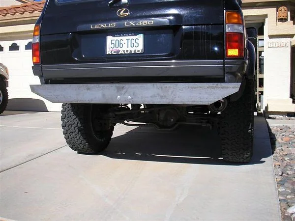

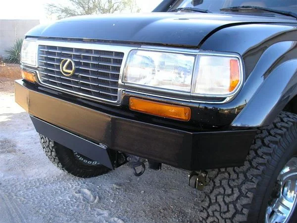

Most of the after market bumpers are C channel shaped shells that go over the stock cross member. The 4x4Labs bumpers replace the cross member, with two 1/4" wings that wrap from inside the frame to the quarter panels, then a 3/16" cross member shell that welds on. The welds start at the top quarter area go across the top, under and inside to the top of the rear shell at the inside of the frame, for about 30" of weld on each side! Then the rear shell is additionally supported by the receiver cross member, making for a very well supported boxed section.
I wheeled mine (80 type) unpainted for over a year. Without the pretty powder coat to worry about, I had no problem with banging it on rock, early, often and sometimes very hard. The angles are perfect for sliding onto and off of rock, obstacles without hanging up or road grading. My guess is that the 1/8" thick frame rails would be bent before any significant damage was done to the bumper.

Quote:
Originally Posted by ShottsUZJ100 View Post
I want the liability on the MAKER....not on me or my mechanic. He said vs she said. No thanks.
Thats pretty rich! Who carries the "liability" on these? The front is only held on by those wimpy stock brackets and two bolts?
