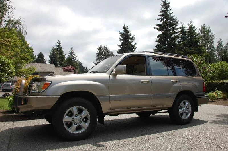

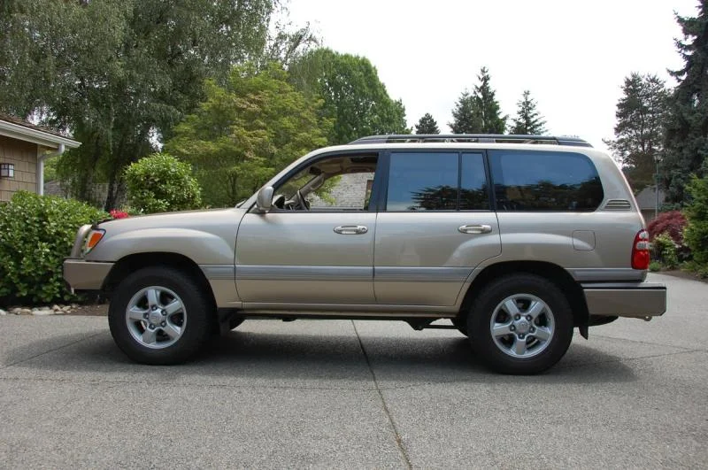

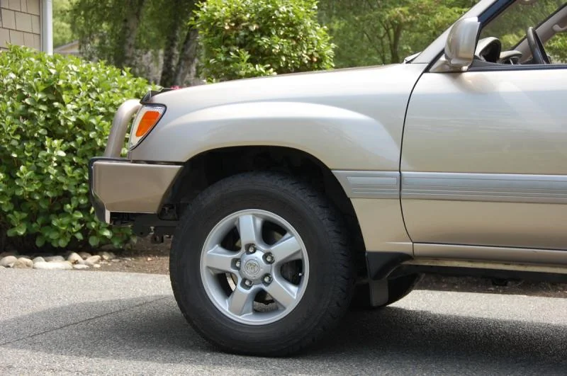

sorry for the delayed pics lasalsa....
I lifted the front again by cranking the t-bars a bit more. I think it's actually pretty level now. I'd say I put it up about 2" but then the bumper and winch brought it down to about a 1.5" lift....
oh, and those are 32" Bridgestone REVO's - next tire will be 33" Cooper Discoverer ST's
side trim is being painted body color in 2 weeks.
