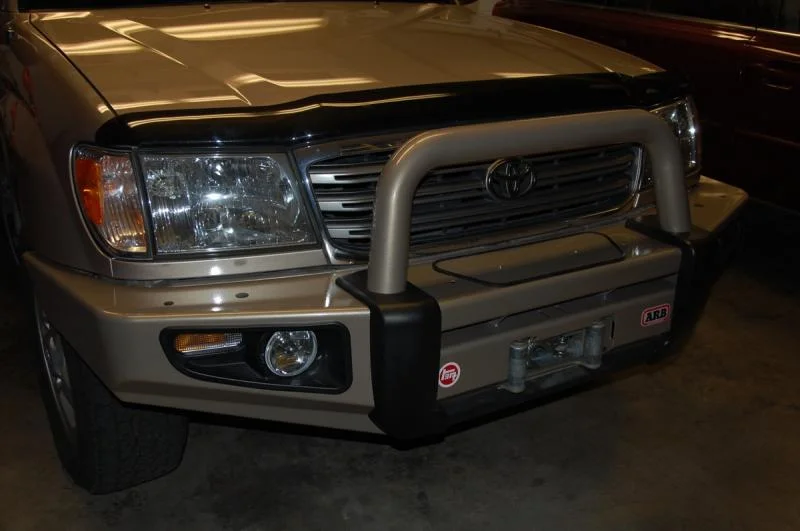

So I stayed up lateTuesday night putting on the front Sahara with lights and the Warn M12,000. Not nearly as bad as the rear ARB... I love the way the front turned out with the matching powder coat - including no more chrome on the hoop. Well, not quite matching, but close, and while it's not the perfect match I have a plan to tie it into the truck. I was originally planning on painting the side trim to match the color of truck but now I think I'll paint it to match the "one shade off" ARB front and rear bumpers. This ought to give it a very slight two-tone look, similar to OEM but no where near as much contrast.
The install was pretty simple and the Warn dropped right in. The previous Warn owner already clocked the motor to get the handle in the right position. All I needed to do was cut out a small 1" x 3" of the inside of the Sahara bar to clear the movement of the winch handle from free spool to engaged. I think that is because the M12,000 has a larger diameter gear housing, took all of 3 min to cure that problem.
The Sahara IPF lights hooked right into the factory wiring for the OEM fogs, as did the ARB marker and blinker, lovin' it. A few quick cuts, some connectors and shrink tube and it's all good.
The warn control box isn't on yet. I am going to mount it inside the grill for a cleaner look. The Warn remote plug will just barely fit between the bottom 2 grill slats, so as long as I can get it mounted securely we should be set. I am going to make new 2AWG leads to the motor as well as to the new battery.
In combination with the rear ARB I am overall a very happy camper.
Suspension: Front dropped 3/4" - very noticeable and I new it would happen. Rear dropped 1/4" (from rear ARM install 2 weeks ago). It actually rides decent right now with stock springs and Bilsteins, but, I need to tweak my T-bars and see how that helps. I will and up going Diff Drop, OME T-bars and springs soon - I'm sure...
Cheers....

So, on the winch, if you clock the gear end so the handle is on the top, does it still fit in the bumper or does the free spool handle hit?

If you clock it to the top (which I tried in an attempt to not have to slightly cut the bumper) it won't work without more of a major mod/cutting etc. I have it clocked to stright ahead and had a cut that small peice. The benefit might be that I can actually move from free to engaged with OUT taking off that winch top cover plate. If that get's to be a pain I'll put hinges on that top cover.
By the way, you can't clock it in between straight up and straight foward, at least I couldn't get the gears to mesh.

I think ARB calls for you to clock it to the back, towards the truck. I'm trying to figure out a good place to put it that you don't have to crawl under the truck or squeeze your hand in to throw the lever. I like that the wiring connections sit on top, makes it easy to get to them. I plan to relocate the solenoid box under the hood.

Oh- one thing I forgot to mention - braking is about 15% decreased with the added weight of all the gear - 2 bumpers, a winch, extra battery - pushing close to 500#
Not sure if clocking it to the back would work or not... all the clocking is done while the bumper is off so I didn't check that scenario..
Yes, suspention next I think... I'll start with cranking the T-bars though and see if that helps...

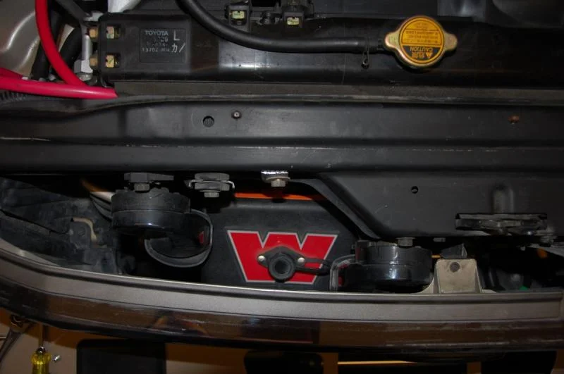

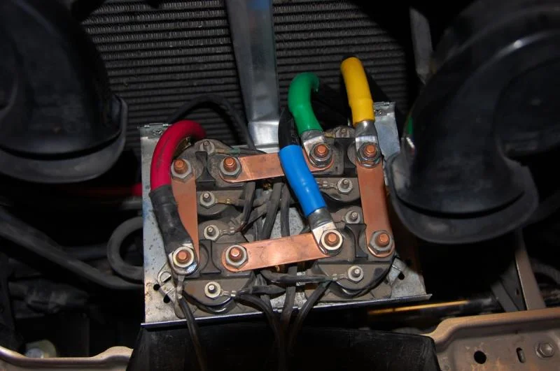

Update - Ok - after cranking the T-bars I am liking the ride so much more. I will wait on the OME lift until I need new tires and go to 33" up from my 32". With the motorcycle on the back it sags a bit - but not all that bad.
Also installed the winch control box behind the grill and ran all new 2AWG wires - I like the clean look. Ran out the cable and rewound it tight and all works great.
I also noticed a nice crunch in the upper rear quarter panel after parking too close to an alley downtown - luck me it was on the same panel that the previous owner had repaired and they BOTCHED the paint match job... SO, going to get that repaired and then have all the trim painted to match the bumpers, which are just a tad off from the body...

Great looking truck! I left my sahara and rear slee bumper original color, but after seeing yours and others I'm starting to like the mono chrome look more and more.
A couple of comments about future supension upgrades.
I went from bilsteins to OME when I lifted my truck. The OME shocks are a disapointment. Wish I could go back to the bilsteins. When I first got my LC I did not like the side to side sway going around corners and the front end dive on fast off road sections. Going to the Billies solved this. With the OME shocks the side to side motion is back, better then stock but no comparison to the bilstein ride.
Here is my suggestion. Check with Christo, about rear springs that will give you extra carrying capacity while maintaining stock lift. This will cure rear end droop. Add 33" tires.This will give you an inch in lift and you don't need to do anything to suspension to fit them. Drive and enjoy.
If your off road adventures demand more lift, then go with the OME shocks, springs and torsion bars. If not stay with the bilsteins.

Yes - the M12K IS a PIG of a winch - the 100 is holding it just great though....
I agree on the Bilsteins and I've heard that from others as well... that some people like them much better than the OME. Honestly, with the Billies and T-bars cranked a bit (give me about an 1" over stock in the front - which matches the back for a straight stance) I really like what I've got for now. I wouldn't mind upgrading to a rear spring that can handle a bit more load but I don't need much more of a lift in the rear - maybe 1" at most would be ok... what OME spring would do that (or is there one??)??
