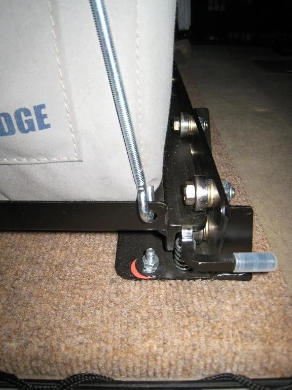

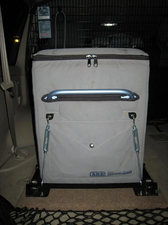

We use these with turn buckles. Putting it where you mentioned works good. Use some 2" or so flat stock and make some tiedown points that you bolt in where the seat brackets go

I used standard turnbuckles like Slee is showing, but flipping the handle upside down prevents the need for those little bracket thingys and you can get the nice turnbuckles @ home depot
I dipped the ends of mine in TOOL DIP plastic coating to prevent scratching

The brackets allow you to still run the transit bag. Flipping the handles does not. Just a FYI.

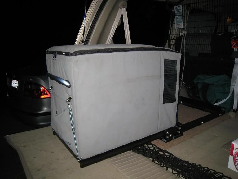

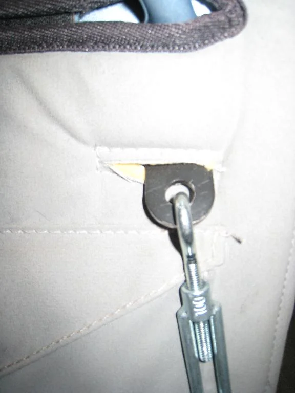

Huh? Yes it does, i ran a transit bag!
There are 4 small slits that need to be opened, but the bag has sewn renforcements in it for them
Here is one BEFORE the transit bag
Here is a closeup (all i got) of the little slit cut for the handle. As you can see the bag is design/setup for it

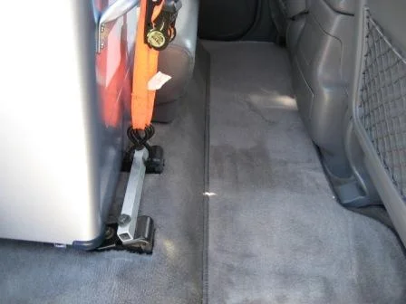

I've tried using ratchet straps on the handles in the standard upright position. It put too much stress on the mounting points.
I've tried flipping the handles upside down to reduce the stress. Worked better, but then made it more difficult to carry the fridge around using the handles.
Best solution I've found is the AO kit that Christo sells (comes with the fridge slider). You keep the stock handles in the normal position for ease of carrying, but it comes with brackets and longer screws to mount under the handles, and the turnbuckles pull on these brackets. I just went out and snapped some pics, shown below:

IH8MUD Lifer

Related question for Derek. How did you get all those bolts through the floor to hold your sliding rack on your frig? I am installing a security box this weekend was didn't want to have to remove the gas tank or any other major surgery just to get some bolts put down.

I will GUESS that the board its mounted to is bolted to the 3rd row seats mounting holes.

so you are saying that I pull the bolts out of the 3rd row mounts, and put in new bolts that are longer and can run through the rack?
Yup. Remove the plastic trim for each of the two mounting points for that side rear seat. Each mounting point has two bolts. Unbolt all four and measure where to drill holes in your slider platform (or whatever you want to bolt in there). Get longer bolts from the hardware store to take into account the thickness of your slider platform, and then bolt in your slider. Use big fender washers.
I used this same method on my 80 and it withstood all kinds of abuse. Plus, it leaves the OEM cargo tie-down hooks free for other things.

There are four bolts in what ends up as a rectangular pattern. No worries about stability, at least for what I've mounted there. But they are narrower left to right, sort of like this (looking from overhead):

I don't have the ARB, but here is my temp mounting solution. I used bungee cords and the floor hooks and seat mounts. For the power I ran 8ga. from my 2nd battery to the rear 12v socket.
The bungee cord will not do it. You need ratchet straps or turnbuckles, etc.
bungee will let the fridge fly and could really mess up your day if passengers aren't wearing helmets

OK I took Christo's advice and used the rear seat bracket holes and cut a 1" x 1" square peace of aluminum tube and drilled holes for the bolts to create a really nice anchor point. If I had more time I would have used turn buckles, but I don’t. I think the ratchet straps will be fine. For the rear I used on of the existing 3rd row seat anchor points to attach the ratchet strap to.
Thanks for all the advice.
