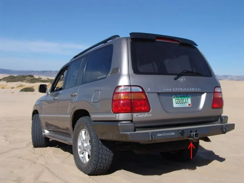

I didn't do it, but the previous owner of my 100 towed a 40 with my 100 with a Slee rear bumper. I've towed a trailer with probably 4500lbs or so in it. They were cows and I didn't weigh each one. It didn't seem to phase it. I am not worried about towing with it for as much as the 100 can handle.

99 UZJ100 "Barnacle Edition" under construction

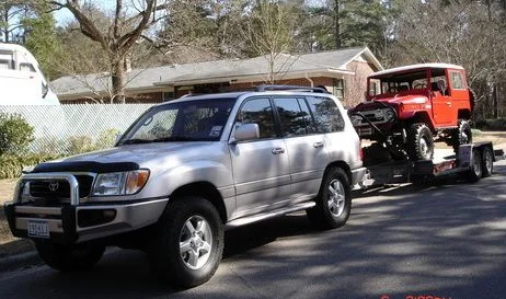

I towed a 40 from GA to VA (roughly 600 miles) using a U-Haul trailer with no issues. There are pictures below...keep in mind the 100 series has 5 extra Wheels/Tired in the rear.

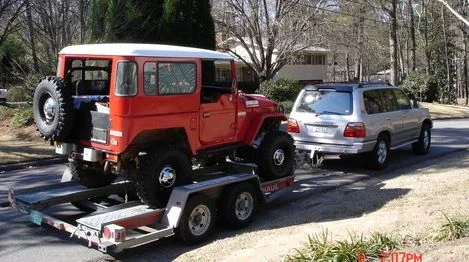

Looks like Christo welded up some loops on this one:
