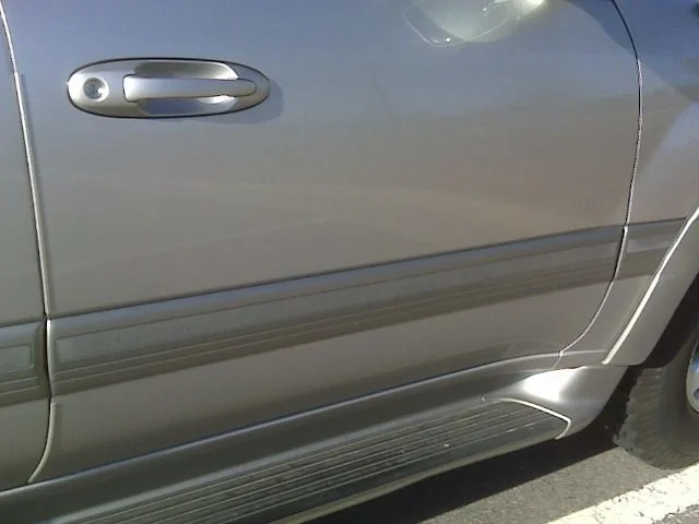

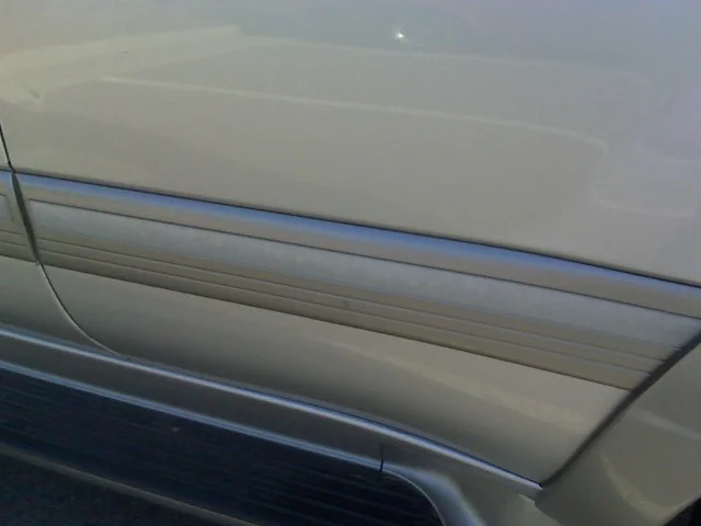

Trim Painting
Has anyone painted the trim on their 100? Did you do it yourself? Any insight? The center section that is painted is faded. It needs paint badly.
Thanks,

I believe they are two different colors....btw mine needs paint, to many door dings...

They are and the center section looks terrible.

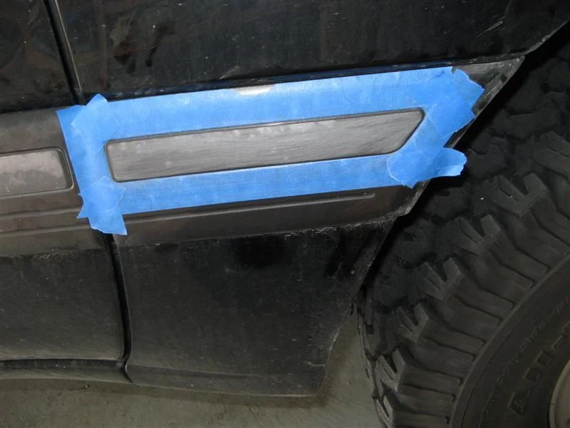

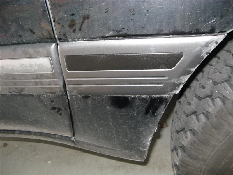

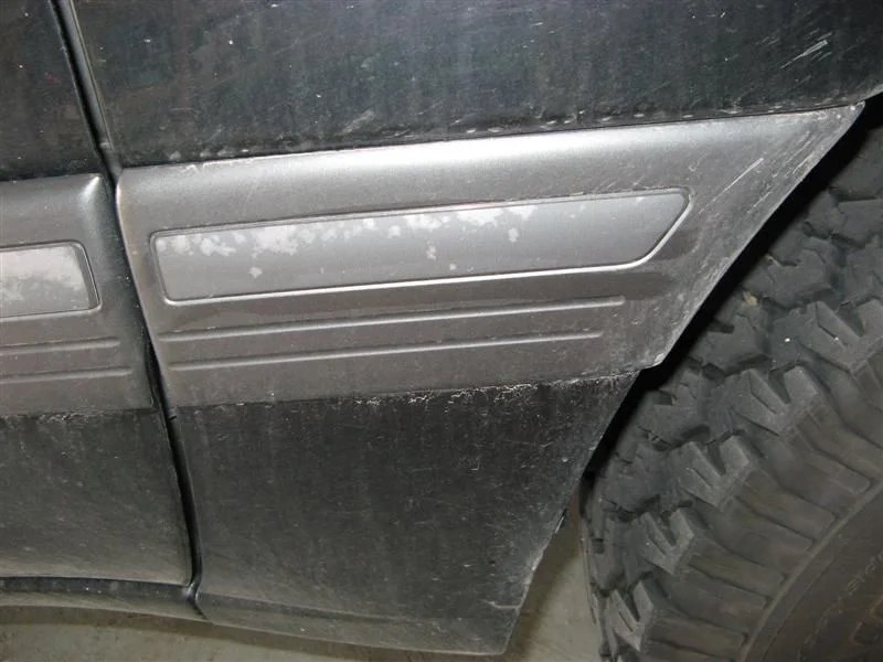

Well, I figured someone had better do something. So, from ugly, to taped and sanded with 120 grit:

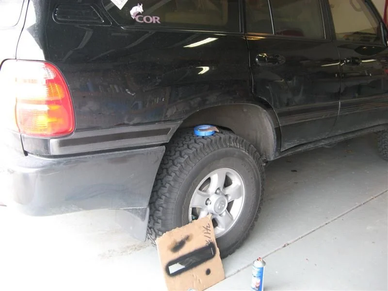

Mas. It's Duplicolor spray on bed liner. It's not as thick as Rhino lining, but it's pretty durable. I used this on my 80 flares and it held up really well.

Looks great. I will be doing the same. I just need to figure out which color to use. Where did you buy the duplicolor spray on liner?
