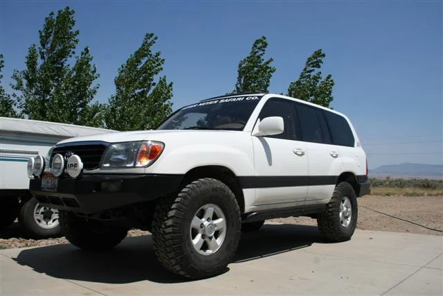

Anyone have any updates on how the do-it-yourself jobs are holding up on the trim?
I'm considering doing mine, but haven't decided whether painting just the weathered inset black would look better or painting the entire trim piece black.
Also, has anyone painted the rear vents in the rear pillar black?
I'm sort of leaning towards doing the inset and the rear vents in black, since I could always go back and do the entire trim piece easier than reverting to the factory color if I didn't like it.
My trim and rear bumper are holding up great after many months and thousands of miles on and off road.

I did mine this AM. I was going to use a semi-gloss black, but then decided to take my wife's advice and use bedliner in a spray can. It looks tons better. It is supposed to be 99 today so it should harden fairly quickly. I've used this before on the flares of my 80 and it held up great.

Looks great!
