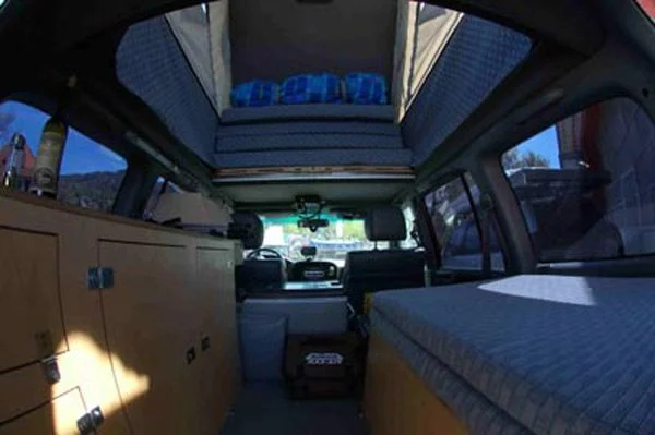

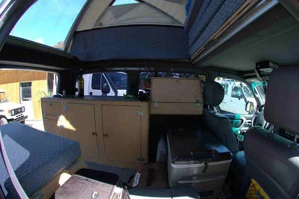

Found a couple more pictures.
Nice setup... I wish I knew more about it.

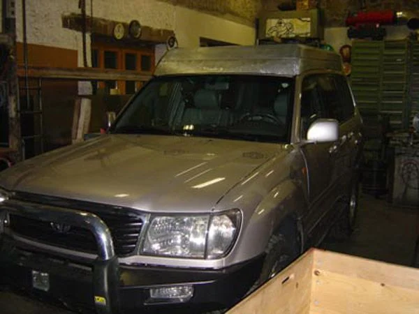

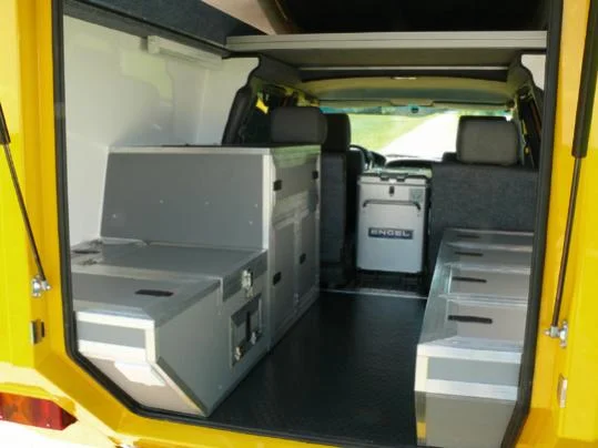

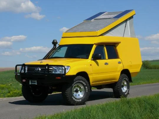

I might as well post the translation of specs and some pics to this thread in case the original site goes away:
ARB 100% lock front and rear
Additional (fuel) tank 147 lt
Webasto heating
Airtec Safarisnorkel
TJM front and rear bumper
4.5 ton winch rope with plasma
TJM Chassis
AT tires 315-75-16
MWM Aufstelldach
Tangier color orange
Engel compressor cooler
Sink with hot-cold water
Boiler about 18 per motor cycle
80 lt water tank
80 watt solar module
1 consumer Gel
IBS-Battery Management

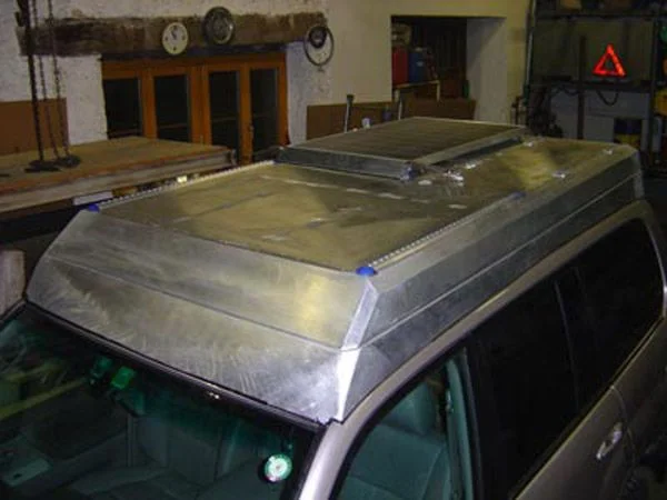

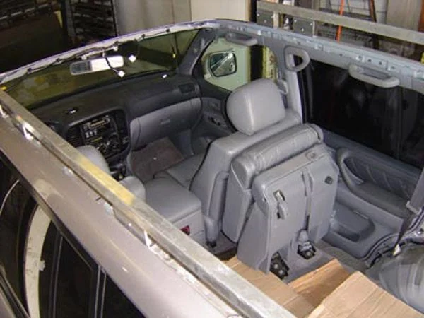

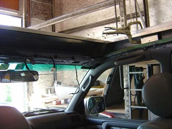

I see they also anchored the top by using the roof rack mounts.

that's an awful lot of roof removed... they had better have added some reinforcements...

Nice, anyone know what the TJM chassis is? Does this mean there are other options for suspension?
It has to be huge for all that weight.

A few more pictures of this camper's build was posted in the 60 section:
View Single Post - Has anyone done this to a 60 or 62?

Hi,
I know this car. The former owner has sold it and now he drives a ... aehm ... a Land Rover Defender 110 ...
The TJM-Truck now belongs to TJM Products (CH) in Thun, Switzerland. These guys use them mainly for advertising at events.
The truck is equipped with TJM torsion bars, the strongest available TJM rear springs and TJM shocks.
Like the most 100 here in Europe its a 1HD-FTE Diesel. The guys told me that the truck is missing a good acceleration due to the weight and 315/75 tires (standard diff ratio).
But its really an impressive truck!

Just throught I would add some new pictures I stumbled across.

Hmm, there's an idea! Replace the larger 2/3 split seat with a 1/3 seat from a RHD 100 and put a fridge in the middle!
