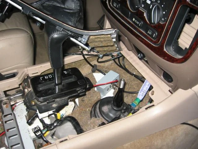

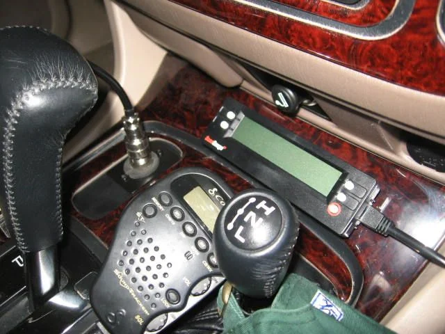

I installed a Cobra 75 WX ST CB and a Scangauge II this weekend. You all weren't kidding about how easy the dash and console parts come out and go back in rattle free. Here are some pictures of my Sunday Afternoon project.
Although not the coolest stuff to install, it looks much cleaner than having all the wires laying around the cabin.

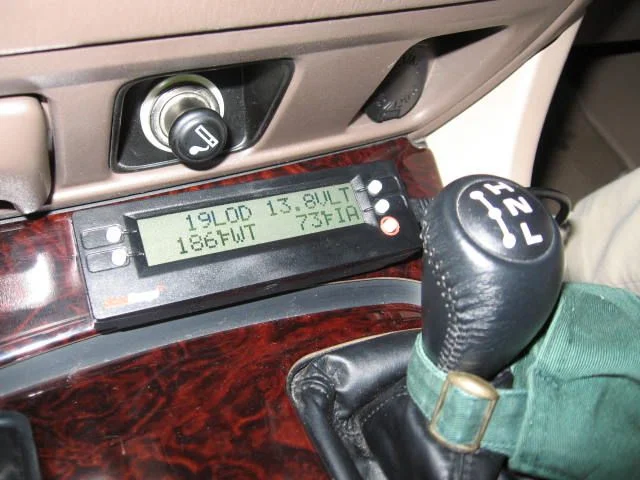

Here is a typical live reading on the scanguage. I haven't done much programming on the guage yet, but it seems pretty customizable if I can find the time.
Water temp stays around 188-193 degrees F.
Intake Air Temp is usually just a few degrees above ambient, untill I stop moving. It climbs up quickly, I have seen it go up to 138.
LOD is a percentage of power currently used by the engine.
VLT is a no brainer.
It can do cost per mile, MPG , and all sorts of other stuff. Anyone else playing with one of these for comparison? I thought Moooooo had one.
Oh yea...it reads and clears MILs too...that's why I got it...I think.

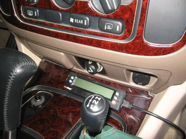

Nice job Travis. I've had the Scan gauge to install for a while...got dig in and get it done. Be sure to download the code definitions so that you have them in the truck if needed...
Thanks spresso...us 20 somethings are always looking for a pat on the back for some reason. I think it comes from up bringing.
I usually have the manual, but a copy of the codes wouldn't be a bad idea for the glove box. Consider it done.
I drove around for 2-3 weeks with it loose, trying different mounting locations. It is nice by the regular gauges, but blocks all of the idiot lights. I like it right on the dash, but too visible for would be thieves and way too much sun for the gauge. I don't need to be looking at that thing all the time anyway, so i just put it down there.
They say it is tough to see if the sun hits it in a certain way, but I haven't had any trouble.
