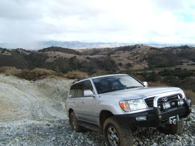

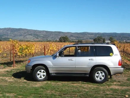

First off, mine is no where near the modified rock crawler that some have built, but it’s my trailer towing/trail support/daily driver that can run some trails. And it works great for me.
1998 Land Cruiser UZJ100
Third row seats removed for more tool boxes
2.5 inch lift with OME 865’s and re-indexed torsion bars.
Custom stainless steel diff drop kit
Upgraded CV boot clamps
TJM T3 front bumper with Warn HS9500 winch/roller fairlead
7 Pin Modification for center diff
4 Low over ride for rear locker
285/75-16 Cooper ST’s and 285/75-16 Bridgestone Dueler AT’s (two sets of rims & tires)
Custom sliders being built
Fabricated transfer case skid plate
Digital trailer brake controller and 12 volts direct to trailer plug
9005 Headlight modification and fog lights too
Custom pinstripes by Manzanita and Aspen

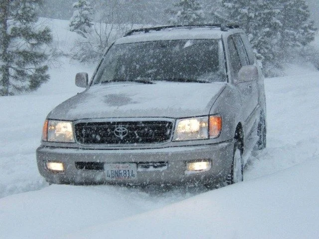

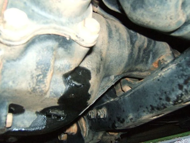

After only owning it for two months, I took the kids snow skiing and thought I’d try out the all wheel drive with street Michelin’s. Not a good idea, but I found the weak link of the 100’s. The two pinion front diff let loose and it was car trailered home. That started a list of modifications, my introduction to the ih8mud forum, and my first thread posting about exploding differentials. After $900 and my own labor, my new front diff was installed.

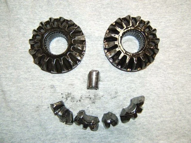

Yeah, three holes in the case

Knowing (or blaming) the street tires caused all my problems (yeah right!) I upgraded my tires to Cooper 285/75-15 ST's and then had to lift it for more clearance. I found a set of used springs from Spressomon, and re-indexed my torsion bars to lift the front to keep the ride quality. After lifting it, I started to notice a small grease leak at the CV boot to axle that was stopped before any damage happened.
And while researching differentials I learned about the diff drop thing and then decided I needed to do my own and my modifications were growing. A couple of trips to the metal supply and machine shop I had my own Diff Drop done with stainless steel.

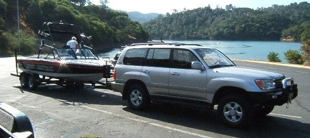

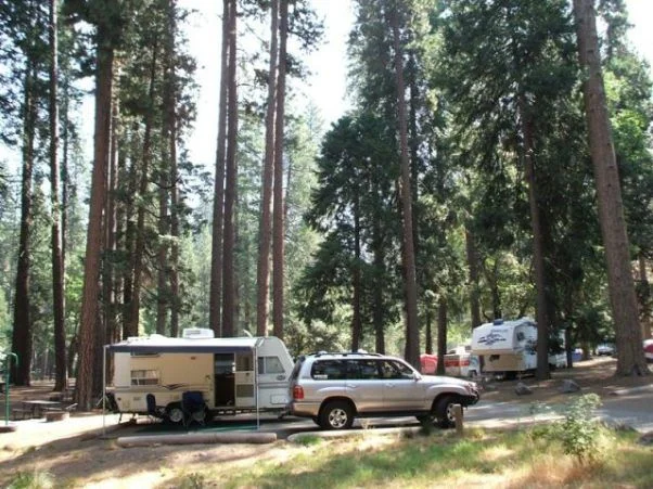

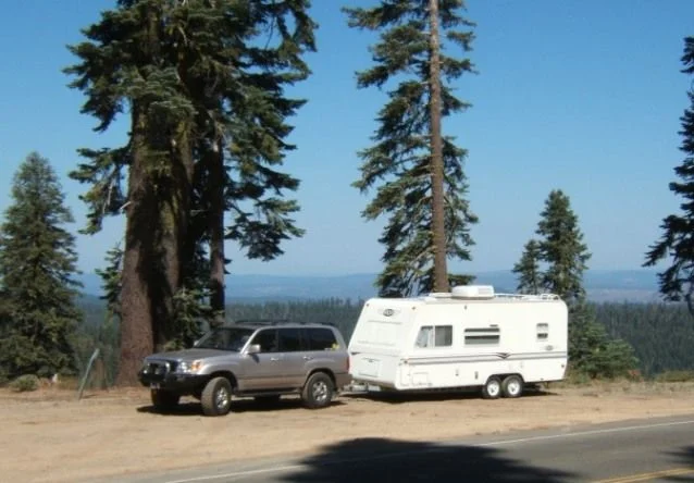

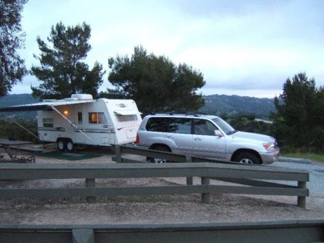

I then started on improving the trailer towing aspect of the Cruiser. The factory setting for the center diff lock to engage when shifting to 4 low bothered me, so a little search and I found the 7 Pin Modification in the FAQ section. I quickly found that using low range while towing boats of the ramp, backing into that camping spot, or backing a car trailer without the center diff locked up was GREAT! I can maneuver my camp trailer into tight spots and never worry about binding up the power train with things locked up.

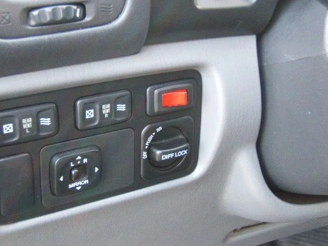

Using that search function, I stumbled across a mod of being able to use the rear locker and we’re off again tapping into wires. I did a write up on the rear locker bypass only to be PM’d and told it was already done.

With all these mods done, I figured it was time to test the snow again and see if I could get past 4 inches of snow without blowing things up. The LC proved to gain my trust and plowed through Iron Mountain Road on a snow run taking on 22 inches before getting stuck.

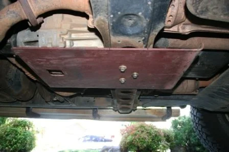

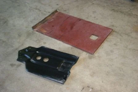

The new plate is at the side yard for the new skid plate, but I couldn't wait for the transfercase plate to go on for a run so it's in place now and will be tied in to the main skid plate.

I have a list of things to improve or modify, but it works great right now for me.

Thanks Phil, the 865's raised the rear about 2.5 inches and "improved" the squat of the rear end with weight on it, but my camp trailer is around 375 lbs tounge weight so I'm going to try the 863's. The ride was just as good as stock with the 865's.

Here's last weekend at Yosemite. The new camera I was using didn't work that well, and it washed out the top of the picture. Half Dome is in the background.
