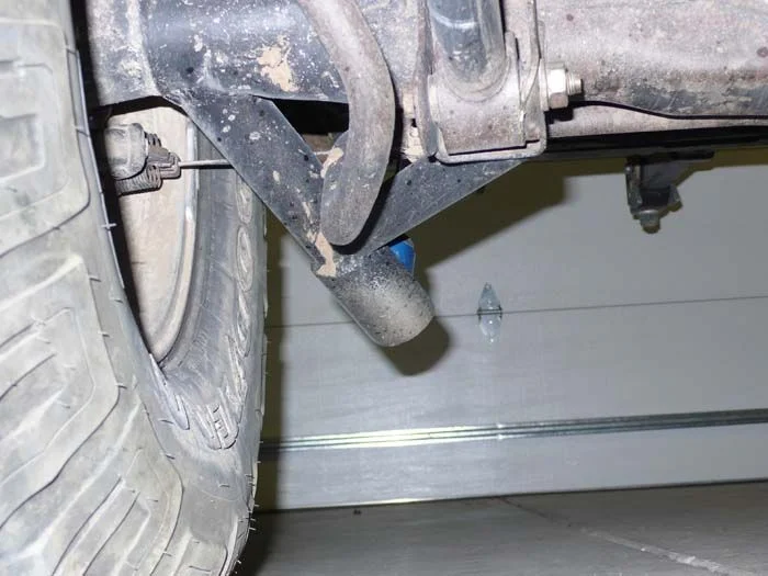

Pics as promised. The DS limits how high the upper mount can be located due to the fuel lines; if not for the fuel lines the shock mounts could have been raised approximately another 1.5"-2" making it ideal IMO. However, the lower mount doesn't hang down quite as far as the stock shock perches and are small dimension/obstacle target left to right. And the shocks are fairly well protected where they now reside without the need to use boots. Sam fabbed the lowers out of 1/4" wall 4130 to take some abuse.

Looks like you already sand blasted the paint off.
You night try epoxy appliance paint. I use it a lot and it holds up much better than regular Krylon or Rustolem.

That is interesting mount. Normally people put the shock directly above the axle for best ride or in front of the axle to gain travel with shorter shock. How much rear wheel travel do you have right now?
The mount looks really good.
Augie is offline   Reply With Quote
Old 10-16-07, 03:41 PM   #113
IH8MUD Lifer
spressomon's Avatar
Join Date: Jan 2005
Location: Reno
Posts: 4,798
Quote:
Didn't measure it Augie. The internal spring bump is the only upside bump I am using and with the 12mm body lift no rub anymore. And downside travel leaves about 1/2" or so of spring pre-load. For the Fox shocks this is max without limiting uptravel.
If the fuel lines were relocated a bit we could move the mounts approximately 1.5-2" higher...that would be perfect IMO. But I'm not embarking on that path anytime soon . I do like having the rear shocks where they are now: Better protection behind the axle housing and much easier to remove for tuning, etc. FWIW: H2 rear shocks are mounted somewhat similarly.
