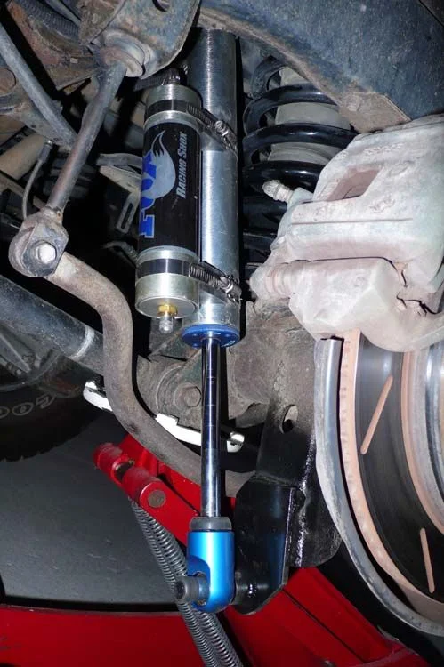

And these are the rears...

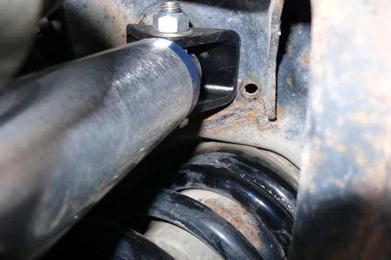

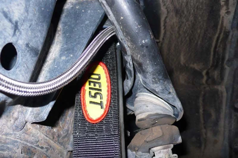

One more pic showing the front shock to upper inner control arm clearance. The smaller diameter shock housing allowed the control arm to droop slightly more than with the OME's.

How much lower is the new bracket to hold the lower rear shock absorber? Is the lower mounting somewhat vulerable to rocks?
The upper rear mounting bracket, how is it connected up there? weld or bolt?

Jay...hmmm I didn't measure how much the lower mount is from stock...I'll have to see if it is vulnerable or not...it looks like it will be OK...but time will answer that question.
The brackets were fabbed as bolt on...so I can reverse the path if necessary back to post style without cutting anything apart (based on how good the Foxes feel on the street I won't be going back to the OME's).
