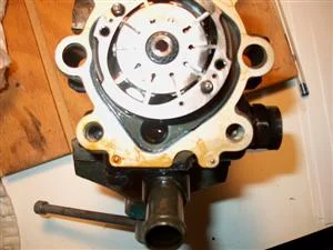

Job Complete
The factory service manual is a must for this job, there are too many parts to keep track of and they go all different directions. Example: SR-44 the Reassembly has marks for the vane pump rotor and the vane plates (10 of them) and they only go in one way and you have to look real close to get it right. FOLLOW THE FSM - no brainier IMHO.
1. The pressure port union bolt is a pain to get off and a pain to get back on. There is a "Stopper" that is designed to lean against the pump body itself to tighten the bolt - mine is a tad bent and it took creative use of tools to hold it in place. Getting it off, there is nothing to stop the feed tube from spinning, so I lost a vent tube - luckily they are plastic and they super glue very nice. Getting it back on, I lost the other - again thank the person for the invention of super glue - these are air tubes and are not under any type of pressure or force - they should hold. If not that piece should be easy to replace.
2. During the rebuild, I was wanting everything to stay in place - give up this idea - the 10 vane plates will fall out, just make sure you keep all 10 and put them back in with the rounded side facing outward.
3. Either mine was rebuilt or the factory forgot some o-rings - according to the fsm, I put in 2 and did not take any out.
4. Don't know if I needed to power bleed the system but after loosing almost a quart of fluid during the removal - yes Murphy's law was right a lot of fluid will come out - I added a bunch back in so I jacked it up and rotated the wheel back and forth a couple of times - bubbles are hard to see in the reservoir, but I think I saw some, so I am glad I bleed the system. - This part was easy and rewarding.
All in all fairly simple, except for holding the Pressure tube in place while getting light on the parts and getting the socket wrench on the bolt - 2 mudders would be nice - of course.
Did not take many pics as I was struggling with holding the parts while wrenching and nothing out of the ordinary that the FSM does not show, so here is a shot for the threads sake.

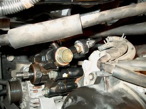

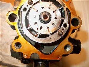

Part 2 - the Correct way
I developed a small leak - nothing big, but a leak just the same and it was annoying after rebuilding the power steering vane pump and waiting for the parts. At least the second time is so much easier, I know what to look for and I know what to avoid. The real key to this job is holding the pressure feed tube in place while taking it off and putting it back on - if you can do that, the rest is straight forward. Oh, and catching the qt of fluid that will leak out
The FSM was a little confusing to me. Just to prove it, it states that both lower engine covers are to come off - er, what for? For the rebuild: It does not have the greatest picture or diagram and indicated that the dimples on the main gasket were to face down - so the first time without using common sense I just put them down and put it back together - See photo number 1. This should have been obvious to me but for some reason it was not (did I mention I am not a mechanic by trade). The hole is the power pump and it uses enough pressure to knock away a piece of the seal to the main gasket and caused a dribble leak.
Photo number 2 is the correct way - to me the dimples are up, but at least it fits better now and it did not leak in the first 20 miles, fingers crossed.
At least the pictures show the interesting pump system with the 10 vane plates that fall out and all over the place - very interesting design.
Cheers - livestrong
