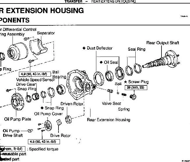

Ah, my fault., You're right Christo, I did mine and you do have to take off the tail housing. Sorry about that Dandon, you are in for a bit of work if you do it yourself. Here is the breakdown from the FSM. You will have to remove the driveline, rear housing, and then breakdown the output shaft to remove/replace the seal.
