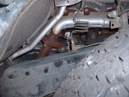

OK, not great photo, but look under:
http://forum.ih8mud.com/showthread.p...ghlight=sensor
post 10. You'll see the O2 sensor.
Or, did find a slightly better picture...
You can see the anti-sway bar in the bottom of the picture. Taken from below, up "along" the firewall. top of photo is towards the rear of the vehicle.
BTW, I did buy my OEM Denso O2 sensor from www.sparkplugs.com. Was just about $100 including shipping. Short pigtail that plugged in like "new". Hence, no splicing of wires, even though that's an easy task as well.
And, the job is VERY easy, as long as your sensor is not stuck.

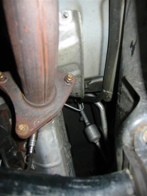

PS O2 sensor from through the wheelwell w/ splash guard removed.
-Mark
