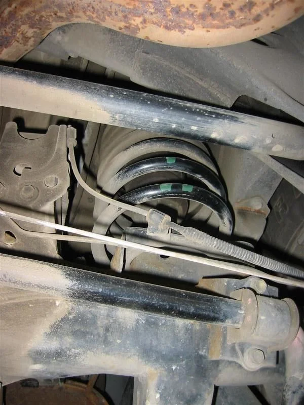

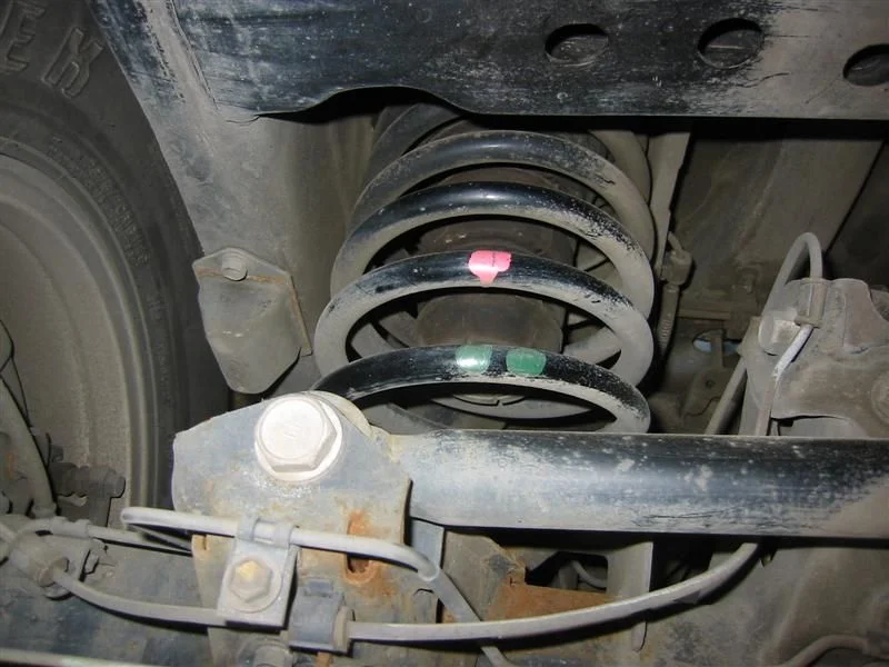

Folks, not sure I dare to ask here (among all the modded LCs) but will try in any case;
Anyone know the spring rates on the stock rear coil springs? Mine are
- Right side: two green dots down low, and one green dot above
- Left side: two green dots down low, and one pink dot above
Truck seem to be leaning a bit to the left, possibly more up front.
Will try to provide more exact measurement soon, but my guess is that front left is close to an inch lower than the right. Can that easily be adjusted by tightening the front left t-bar?
If recommendation is to replace rear coils, (they have about 80K miles) how much "lift" can be expected from new (stock) coils? Reason for asking is that garage opening is LOW as it is and rubber seal around it sometimes touch the roof rack. Hence, few chances for any serious lift or 285s for me... (I like to park the truck inside).
Thnx

It should be the same spring rate. The height are slightly different. I believe the taller one on driver's side.
You could adjust the leaning by adjusting the torsion bar.

I would start by adjusting the t-bar that is lower. That will level out the front and may even affect the rear enough that it levels out too. Otherwise, you can purchase OME trim packers (poly spacers) in 5 mm and 10 mm heights to space out the rear coils. I doubt the rear coils are spent at 80K miles. Upgrading/replacing the shocks may not be a bad idea though. Several here have been very happy with the stock springs and Bilstein shocks.
