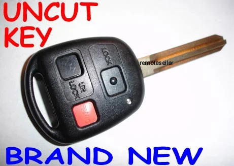

Ok, so if a person wants to get another Master - remote key and has the master, where is the best place to purchase one? I wrote to Charlie and I will call Dan when I order my other items, but thought I would ask.
I found one on ebay for $85 - is this right? I thought I read $35, but do not know if this is the remote door locks key or just another valet.

Huh, looks like this thread is abandoned?
Anyone buy a key (UNCUT KEYLESS ENTRY REMOTE KEY) from an ebay seller that they would recommend?
Like this:

I would ask them it they send remote key programming instructions with the key. If they do, I would not hesitate to buy it.

i got one like that off ebay and had it cut for free by toyota. now i have to program it .rub head,pat tu
