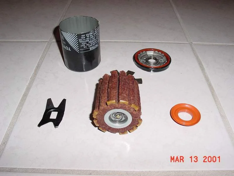

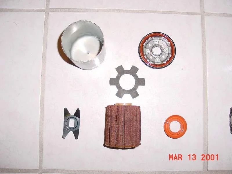

You really need to open up a 20004 filter, generally considered the gold standard reference.
BTW, here is a link with picts of the 20004 cut open.
http://www.mkiv.com/techarticles/par...ter/index.html

good number of things that would be neat to measure, if somewhat unpractical...
already great to see the insides, though.
Yup, the 20004 stands out!

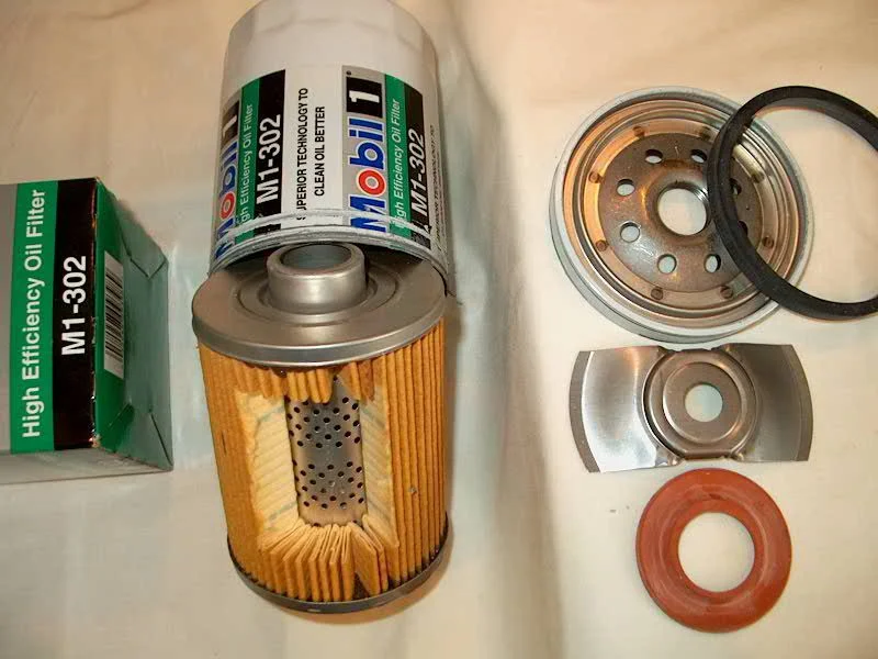

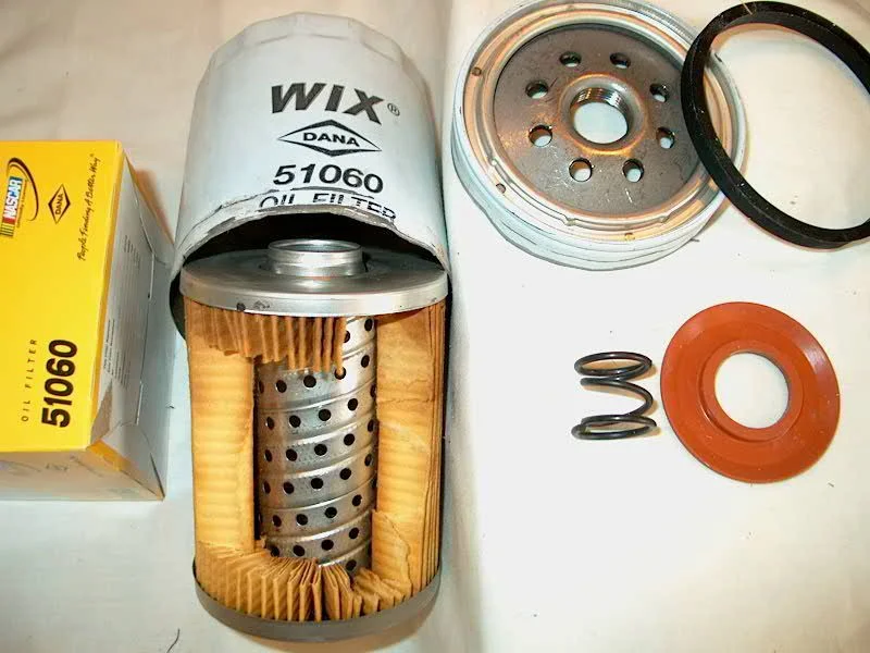

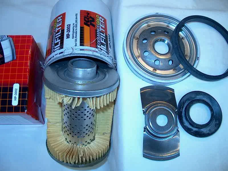

Originally Posted by Jim_Chow View Post
How about the hyped substitute for the legendary -20004, the Mobil 1/Wix filter?
Ask and you shall receive:
http://www.oilfilterstudy.com/

Thanks, I had a just bought a bunch of these to do this myself.
looks like the K&N and Mobil 1 are the same and the toyota V8 is completely different. Wicks did not inpress me with the number of pleats. Does anybody know what the red material is made of? Also, toyota rarely recomends going over the 5,000 mile mark and depending on which dealer I ask the always say use MOBILE 1 or Castrol blends. Either way, Mobile 1's filter says safe to 15k I wonder if it is worth it to try and run this?

The M1/Wix filter look no better than the YZZD3, even looking at the size of the holes in the center metal core. Both use paper media. The only one that's clearly different is the factory Toyota -20004.

I'll be happy to open any filter you want to send me once I get my methods and data collection requirements together.
The real question with the 20004 is ... is the "beef jerky" media really better?
