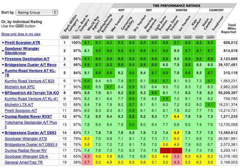

I'd prefer the Revo's or the Nitto's as well. They have a good reputation and a proven track record. But just to compare...
The Revos show up as $180 on Tirerack and the NTG are $182 at Discount Tire.
$180x5 (Revo or Nitto TG)=$900
$109x5 (Kumho)=$545
So $545 vs $900. A difference of $355. Or you can say the Revos/Nittos cost 65% more than the Kumhos.
This is tire rack's survey on AT tires. Take it for what you'd take a survey for. The Kumho is a newcomer, so there isn't a lot of data on it yet.
