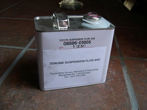

It's a 2.5 liter can, not 4 liter, sorry.
